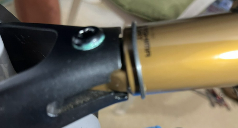

Installed offset hardware. I was going to install one end, specifically the rear offset hardware. But I found out that there is not enough space between the Float X shock and the Rise's shock extender. So I ended up installing the offset hardware for the front. It probably works just fine with the Fox DPX2 rear.
would it have been possible to flip the shock?
It is the space between the shock and the extender. The rear offset hardware will close the gap shown below and the bolt will not line up. I can certainly force it, but it doesn't seem right.
(sorry bad photo) This is with the OEM hardware. The gap between the shock extender (black piece that looks like a turkey wish bone) and the end of the shock stanchion doesn't not provide enough space. The offset hardware will close that gap and make it impossible to line up the bolt, as the stanchion is butting up right to the shock extender.
