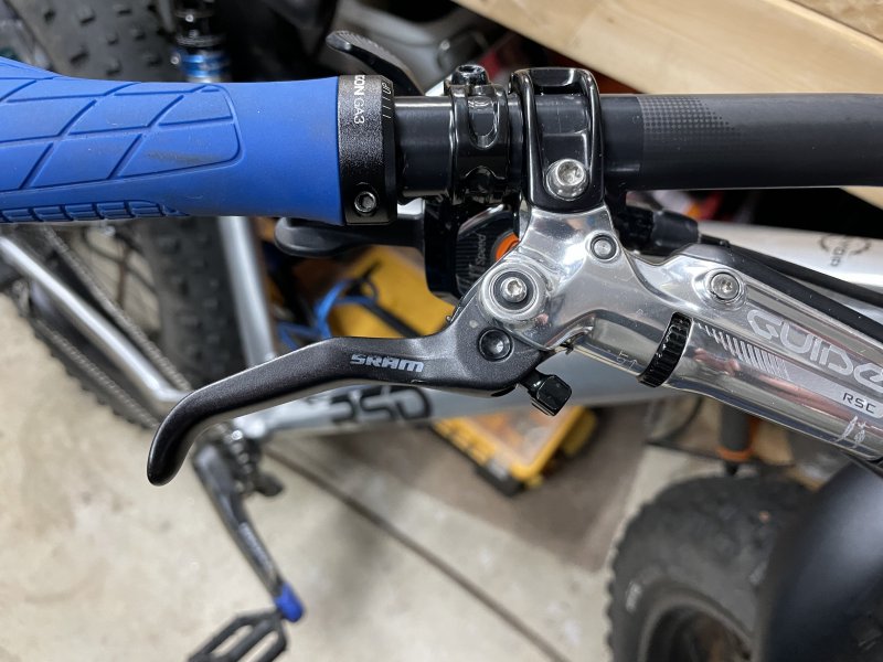

And noticed the Element front brake was pulling quite close to the lever so gave it a quick bleed and noticed the pads were most likely the culprit in the process. Also one of the pistons was pretty lackluster in movement so cleaned that up with some q tips.
