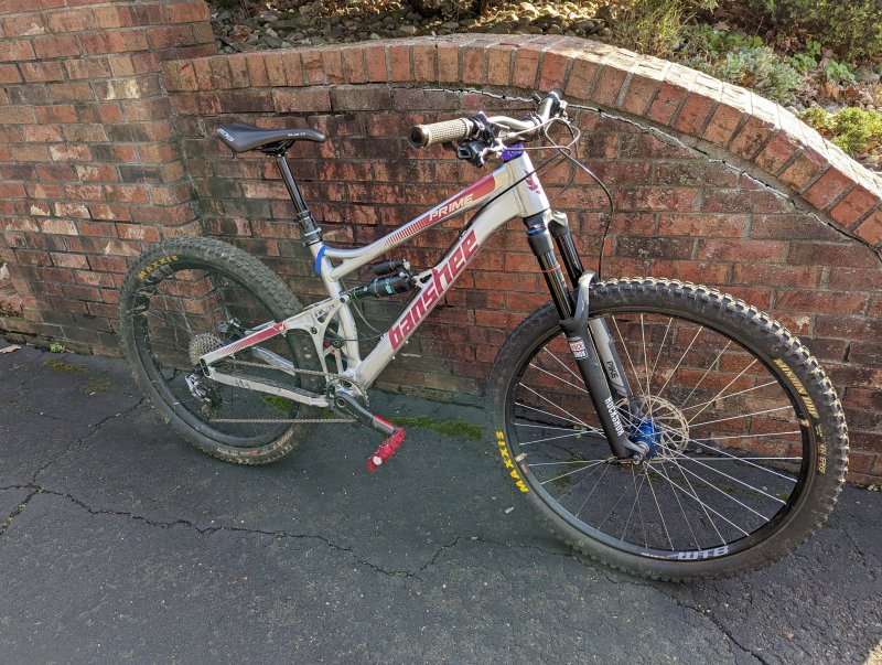

I put together a set of wheels for my fuel ex with arch hoops and origin8(I know but I already had them) hubs and swapped the minions to the 30mm WTB rims/Stan's hubs I've been riding. I'm putting the WTB trail bosses I was riding on the new wheelset for places like 6mile, Allaire, and Nassau(faster flowy parks) since the tires are faster rolling but the hubs are lower engagement and using the minion/higher engagement combo for tech places where I need traction and more ratchet pedaling. I just need to finish truing(they're within a mm or so but I'm a bit of a perfectionist sometimes) the new set and tape them up and they'll be ready to go.
Setting up a dirt jumper and have questions on the stack height. What's the typical people are using?
It's always been low stem and tall bars for me. I guess it goes back to my BMX days in the 80's and I ran the quill stems slammed for less flex. Plus it looks so much better.
Last couple of years I've been running a small spacer (10mm) under my Deity stem and the tallest bar (80mm / 3") Deity makes.
Is that an old Ellsworth DJ frame?
Yep, a gen1 Specialist. Bought it years ago to replace a Zaskar but got into 29rs and pretty much forgot about it till now. Climbs like a pig but still fun going down. Lol, 80mm rise, I don't have anything close. But that helps to figure out my setup. Thanks
