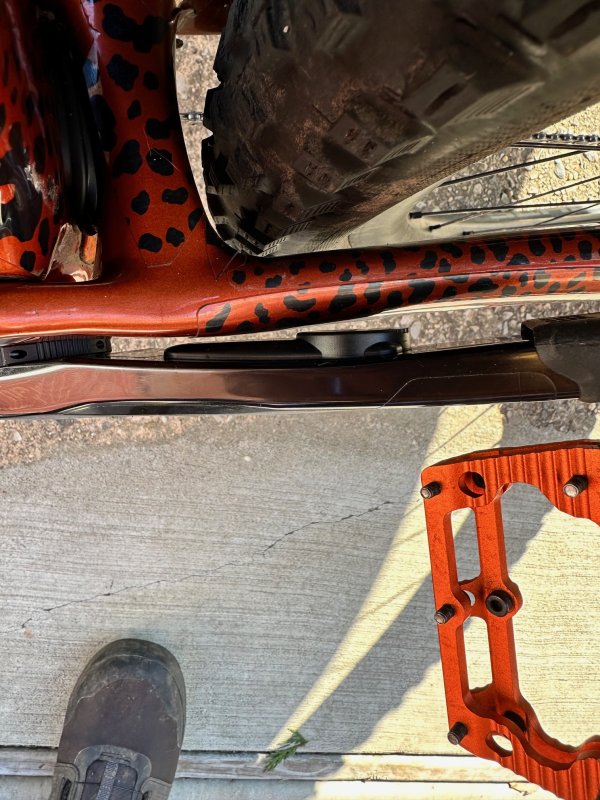

You can put a spacer behind the BB cup on the NDS to get yourself an extra 2.5mm. Unless the chainring is that close also in which case…Godspeed 😂
Good idea. I'll see how lazy I'm feeling over my holiday break and consider pulling the BB to do that.

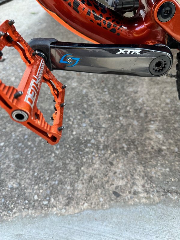

Dunno? 🤷‍♂️ I'm clipped in on the road, haven't committed to doing so on the trails (may never). It's not for training, just a tool to get a sense of where I am at on any given effort.
Which power meter is that? I'd be curious to know your thoughts on this after you've had a chance to test it out -- do power meters and flats mix? Good luck with it, and thanks!
That's a Stages. These measure flex in the crankarm so the pedals won't matter. You also put out 99.999999999999999% of your power out on the downstroke unlike what you might have been told by various cycling channels, people, and the industry as a whole.
Like @Steve Vai said, it's a Stages. I rode it yesterday, seemed to be a bit higher than my perceived effort when compared to what I am used to seeing from my road bike (Pioneer unit). I'll continue to play around with it. Like I was saying it's more a novelty than a true training tool at this point.

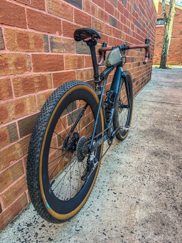

SLX calipers for the gravel rig finally arrived. Installed them, the levers, bled the system. Of course, I lost the I-SPEC retaining nut for the shifter into sock/small parts hell, so there's that.
