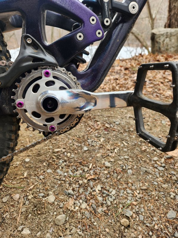

Installed the works 30t

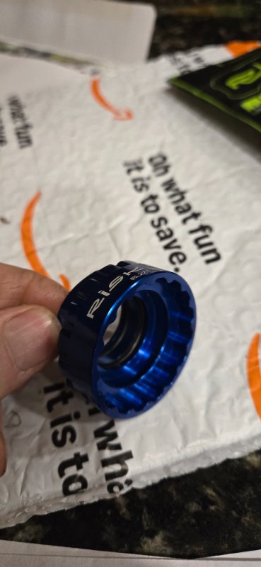

Bought a Amazon tool to remove said chainring.
Also had to remove 1 link from the chain

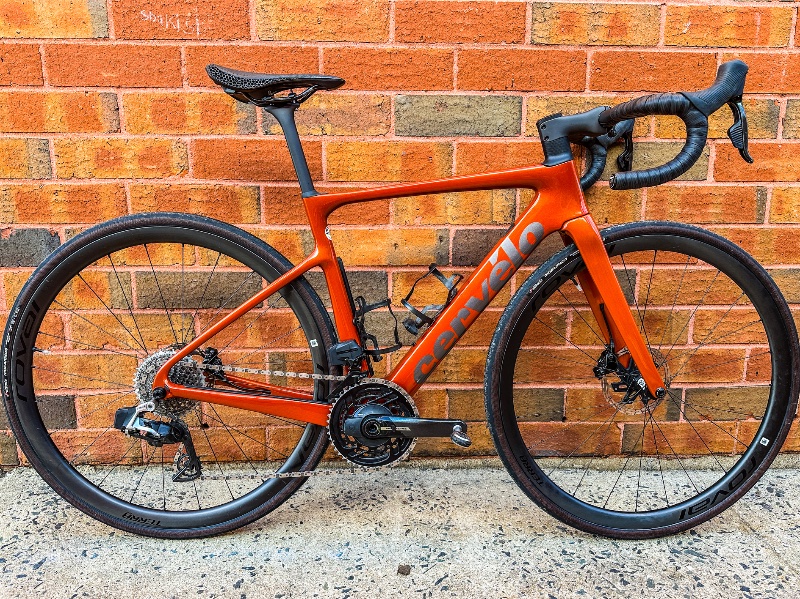

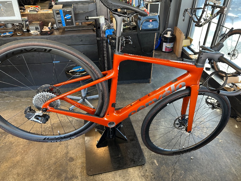

Are you speaking figuratively I suppose...doesn't the Paris-Roubaix frame wright about 2 lbs!?!?! Wouldn't that make that Cervelo -2 lbs heavy?
The Futureshock is the heavy part. Roubaix frame itself is actually light. And the fork is heavy because it’s a Diverge fork instead of a road fork. And the Pave post is heavier than a road post. Think of the Roubaix as a light Gravel Bike.

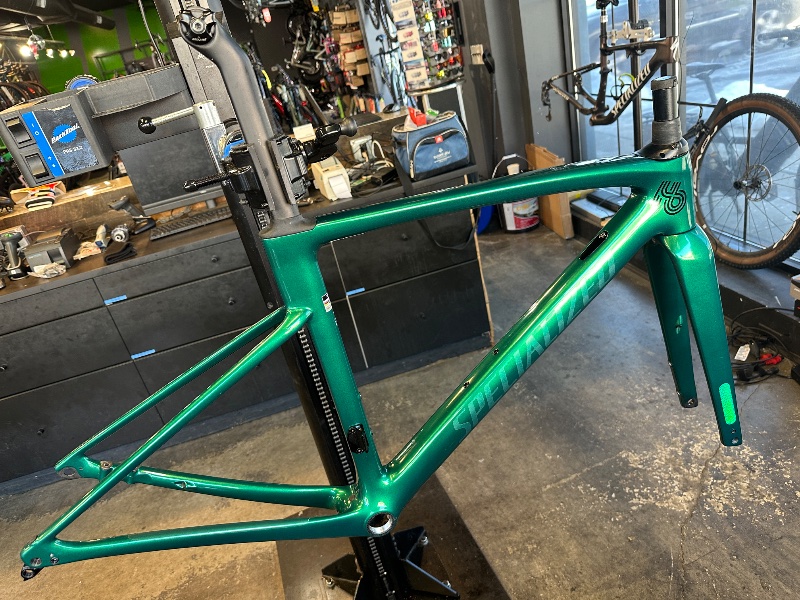

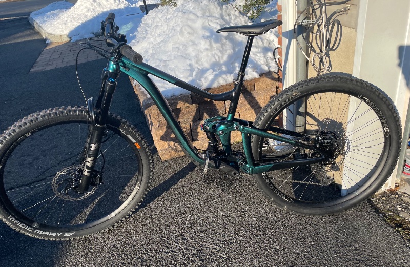

Warranty frame replacement
Orbea exchanged Aluminum for Carbon
Love that raw carbon look

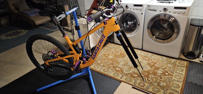

Swapped fasst flexx bars for 50mm rise PNW loams
Swapped drivetrain from microshift to Linkglide
Installed Reverb over cable dropper
Wheels were ones I built for the nimble 9 switched over to this bike and added steel hub drive. Added Vittoria tire insert to rear.
Shreddas front and rear. Fork was recently serviced as well. Added 220mm front rotor.
Basically new not new bike day!!!
All thanks to J and the boys at Halters!!!

Was planning to mess with a rear tire insert on the Ragley. The words "compliant" and "smooth" are not in Ragley's dictionary so wanna try a little lower pressure without killing rims. Noticed the derailleur was more sideways than straight. Handy dandy cheap ass Amazon alignment tool to the rescue. Looking for a spare hanger but they're out of biz, I think there's a couple companies making repops out there. Also broke my B-screw guide but still mostly works just doesn't clip on.
Next, I'm looking at a brake bleed kit for the Diverge (GRX). Left lever goes all the way back to the bar. I think I just need the port extension adaptor for the Shimano funnel but might get a whole kit and make life easier. Was a little sketch Saturday on the downhills.
Ended up buying a full Bleedzone kit ($20 on Amazon and all worked fine) and glad I did. There was no fluid visible in the lever reservoir. Why? Dunno. Was a little nervous if a bleed would be the answer but fortunately it was. Shimano mtn levers have some known leak issues, not sure about road stuff. Anyway.
Ton of air in the front system which was gratifying to see, little bit in the rear. Blew the syringe off the rear nipple at one point and took a mineral oil shower. Funky. Let's see how it holds up but good for now.

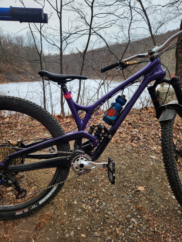

I have been preparing for this season.
-F & R 1.8 thickness Galfer rotors
-Schwable Magic Mary Super Ground soft 2.4
-Kenda Karma Pro 2 SCT 2.4
-TrailOne Hell grips
- Neutral flip chip from a newer model Trance X. I ride exclusively in high but find it’s sometimes too steep. I am most excited by this.
Now I need warm weather…
