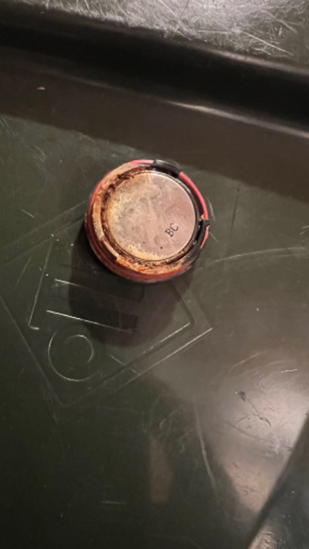

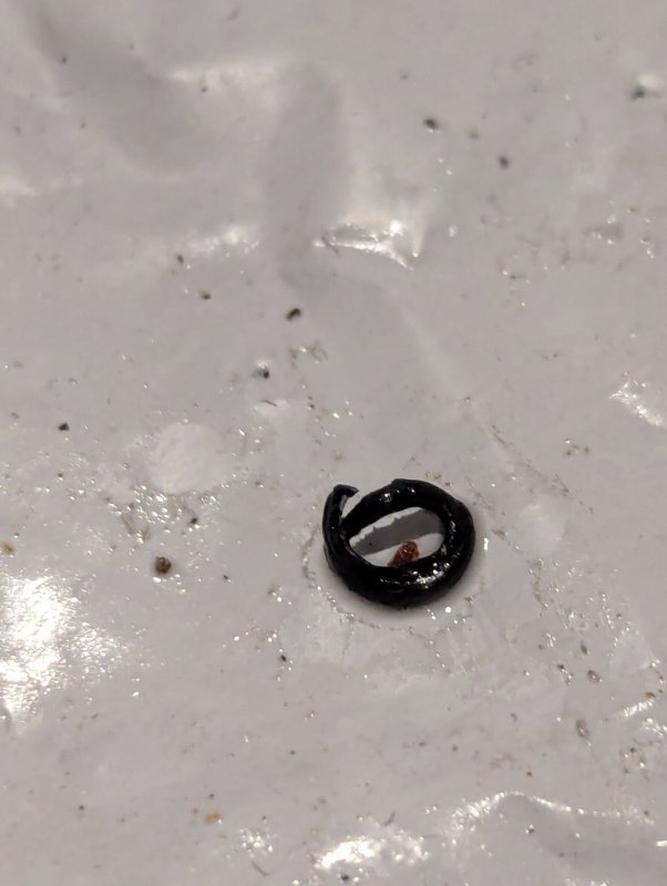

Having a rough time bleeding road brakes, they are SRAM Rivals.
View attachment 262709 This came out when I removed the bleed port screw. Is it a seal? I don't see it in the diagrams.

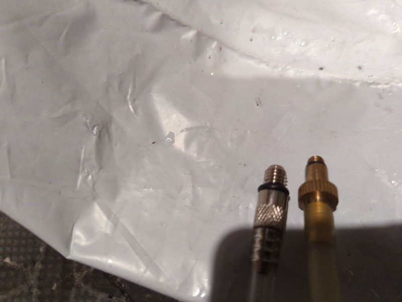

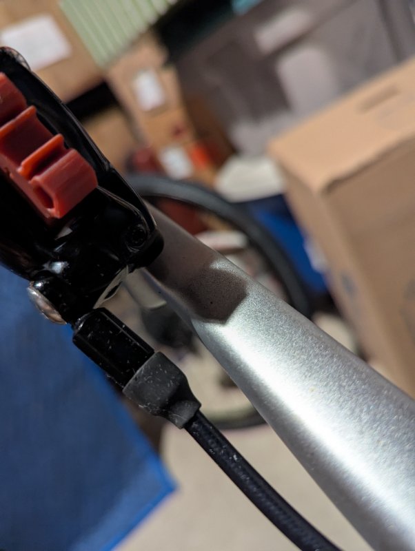

I got a new kit with o-rings from Bell's, but it not the right thread size. Have been using the same kit from Juicys to these Rivals and it's been the same. Which ones have coarser threads? Or did they send me the wrong kit, says SRAM/Avid on the box. The one on the left is the new kit. Regardless, sending these back.There’s a bag of these little o-rings included with the bleed kit. Unless you some Temu bullshit, then you’re beat.
Can you find out the size? I have two bags one for Shimano and one for Formula maybe one could do?I got a new kit with o-rings from Bell's, but it not the right thread size. Have been using the same kit from Juicys to these Rivals and it's been the same. Which ones have coarser threads? Or did they send me the wrong kit, says SRAM/Avid on the box. The one on the left is the new kit. Regardless, sending these back.View attachment 262739
Formula is same as sramCan you find out the size? I have two bags one for Shimano and one for Formula maybe one could do?
There you go! I used them to connect the Formula quick change adapter to my Shimano caliper, the Formula adapter leaked but the o-rings at the banjo were perfect.Formula is same as sram

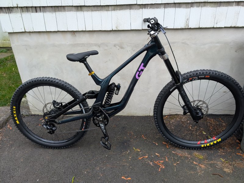

Do you own a yellow marker?Big gravel event is over so I put more appropriate shoes on. One white Maxxis and one yellow bugs me....
Where did you find the sun?View attachment 262777

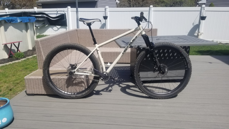

I built up a new hardtail recently. Everything carried over from my old bike except the bottom bracket and headset. Can't wait to add a bunch of miles this summer.
Yeah, but I want them both white. Maybe I'll blackout both of them.Do you own a yellow marker?

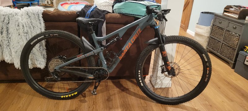

I bought a transition Spur All country bike.
Hopefully it shows up and I didn't get scammed.
