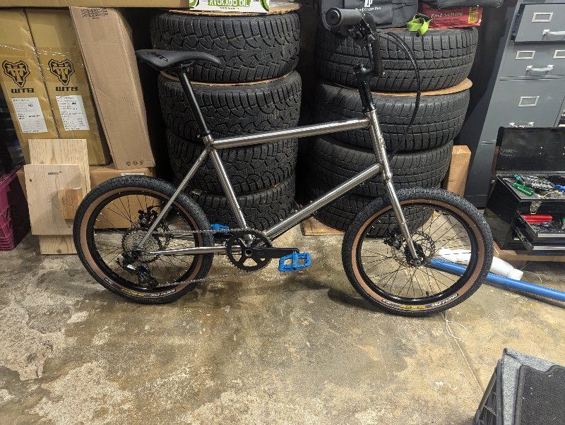

The little lady had been hinting around for a bike off and on. So after kicking it around a bit, we decided on a Kyoot Rolly Polly Mini Velo. This way, we both can use it.
Took it out for a quick spin after getting it all together, it's a mite twitchy but I'm looking forward to seeing how it feels after getting it dialed in and putting some miles on it.

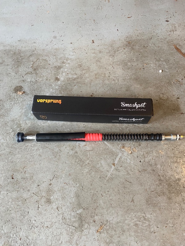

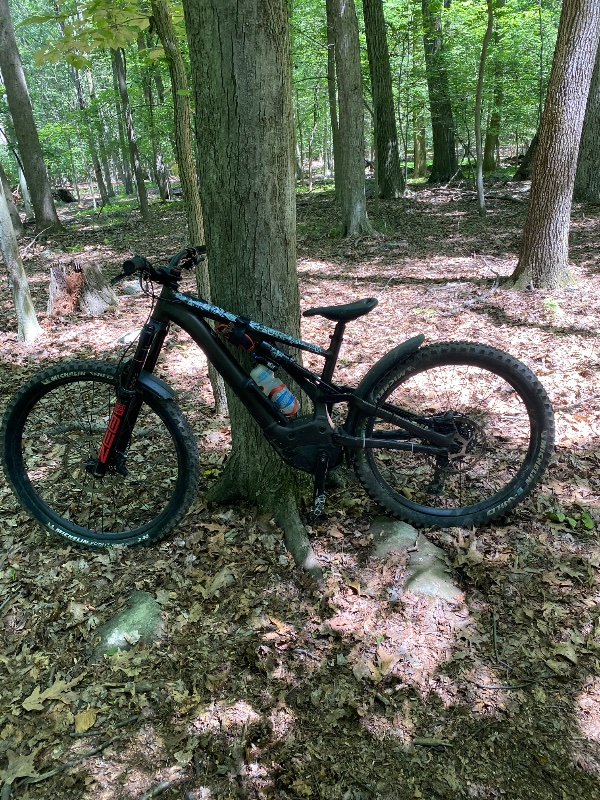

Just so tired of the “wall of resistance “ that is the rockshox Zeb air spring. I guess it would great if I was doing hucks to flat but I am never getting more than 140mm travel out of 170mm travel. I picked up a vorsprung smash pot coil kit and tried it on a 27.5 Zeb with 180mm travel. It was ok but it added a pound to the front of the bike and the Kenevo seemed to get caught up on the rock gardens. Fun fact, on most Rockshox forks you can change them from 27.5 to 29er by just changing the lower legs. I picked up a a 29er lower assembly and a 170mm air spring on eBay for cheap. I switched the lowers and converted back to an air spring on…. Great roll over with the 29er but the ramp up on the air spring is crazy. Soooo I converted the travel on the spring to 170mm on stuck it into the Zeb again….. trying it out tomorrow.

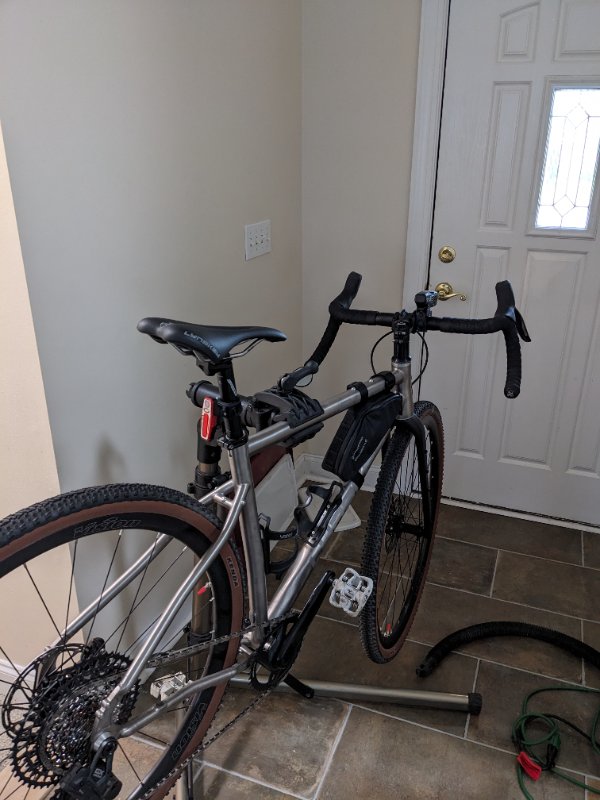

Realizing I'll have to start rides at dusk (so I don't melt), installed front and rear lights.
The nightrider rear flasher is so bright if someone tails me they'll have a seizure .
Yes. I'm working on the bike inside, too hot in the garage
Consider a garmin radar like the prev model RTL515. Especially if riding at that time of day you will want to know cars are coming behind you as soon as possible.

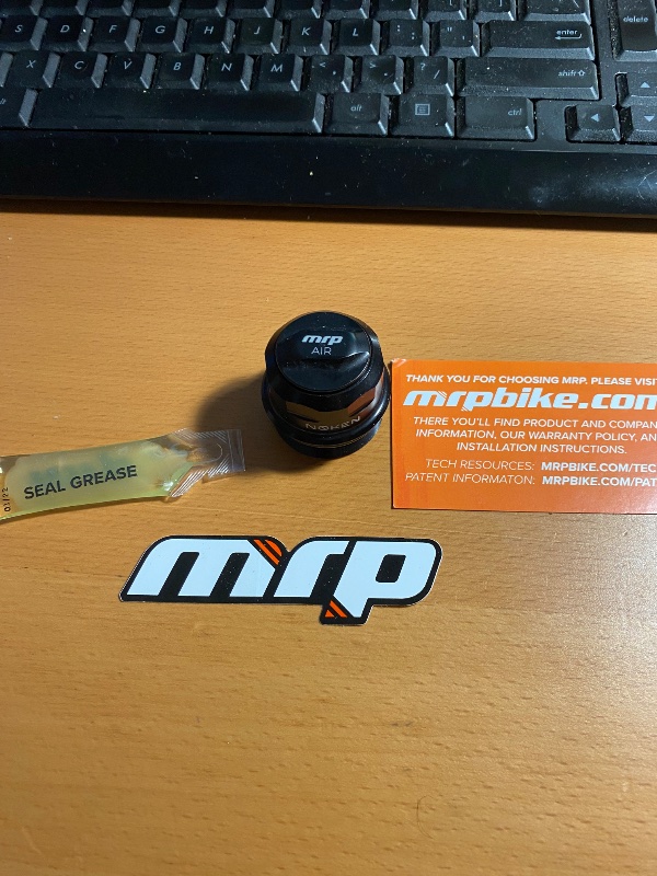

Imo the air spring in the Zeb has to much progression, adding tokens just makes it worse. I even tried the MRP air spring extension and I still couldn’t get the fell right.View attachment 263522
Simple trick with zeb is to undo the lower foot nuts , break the seal and re install foot nuts but with the fork an inch or 2 into the travel . Alot of the ramp up is from the lowers not the actual air spring .
