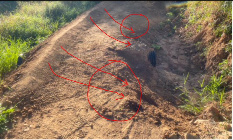

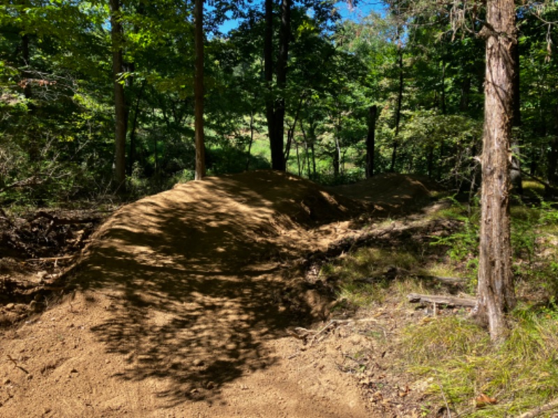

Not trying to be a d!ck and criticize, but just want to offer advice. For this specific turn, it looks more like a curb than a berm. I would dig out a bunch of dirt in the circled areas and dig a smooth transition from the outside of your turn down to the level of the inside low spot. This would make a much bigger berm to hold you better and you can use all the dirt you dig out to build up the outside of this turn or other features.
I agree with you but, I think the drainage pipe forces the inside of the turn to be higher.
Also, not to be a dick. My thoughts;
I agree on more dishing of this berm, however I would recut the inside radius for fill to dish inslope.
If the line is being pushed out for more radius, the inside edge of trail can be cut for fill dirt. This would be quicker with mini-ex hogging it out and hand grading a dished berm.
Dig, ride, dig, ride...

This exactly. This is what I typically do with this trail. I go out for a few hours and do that cycle. I will ride it a few times, then go work on it for an hour or so. Then I'll ride it again a few more times but then usually go home because it's exhausting.

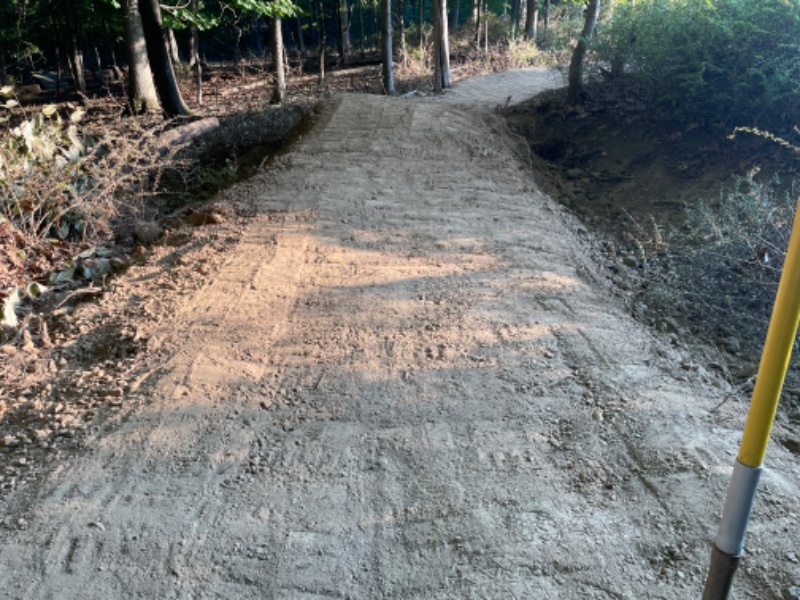

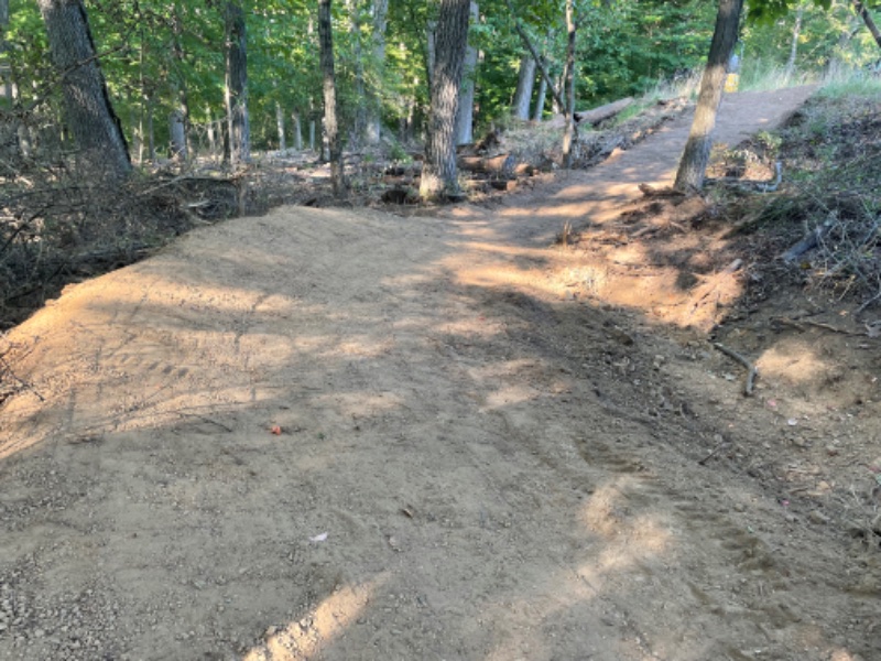

The dirt in that turn is like cement. I know it's easy to draw red penises on the picture and suggest what should be changed, but this shit is like prison camp labor. I use a pick to loosen it up, then I turn it around dig a bit more, then McCloud with teeth, then flat edge of McCloud to scrape the rock-loaded dirt. What you see is 3 passes of that 4-step process added up over the course of an hour. My point is that this is kinda brutal to work with. So I do a little bit at a time. In addition, this dirt is absolutely loaded with rocks. Some baby heads, some pebbles, and everything in between. During the process I'm trying to scrape as many of the rocks out & over the top to the backside - an impossible task.
Another reality is that this will pack in and 1000000000 small rocks will show up. Every new trail in CR goes through this cycle. Dirt looks nice and smooth, then in about 8 minutes there are 4-5 million rocks freely moving on the top. So my MO is to assume I'll need to go back and do a second finishing/scraping of the rocks. Once the base packs in a little, then I can think a bit longer term with any trail here.

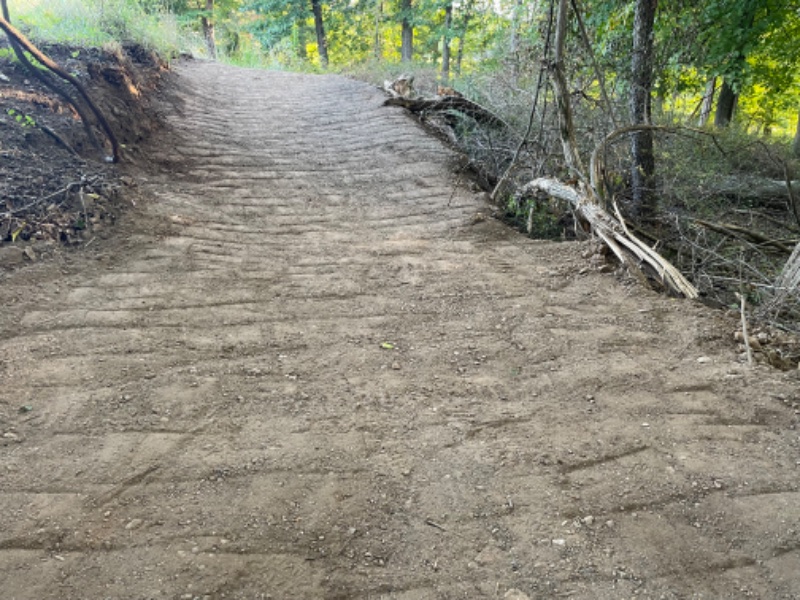

I'm now somewhat obsessed with grooming the Shed Trail properly. Spent 2.5 hours out there again tonight. I did ride it a few times and it needs to a) be finished top to bottom, b) to be ridden, and c) rain. I'll take care of A as quickly as I can. I ask all y'all to do B. And if anyone knows a good rain dance, I'll leave C to you.
It'll be a bit but it's coming along. I think there will be some tweaks as it firms up and rides in. Don't love the entrance so much as-is. I have ideas.
