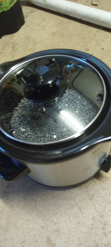

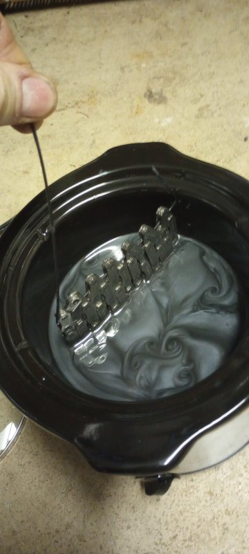

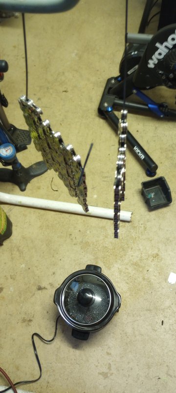

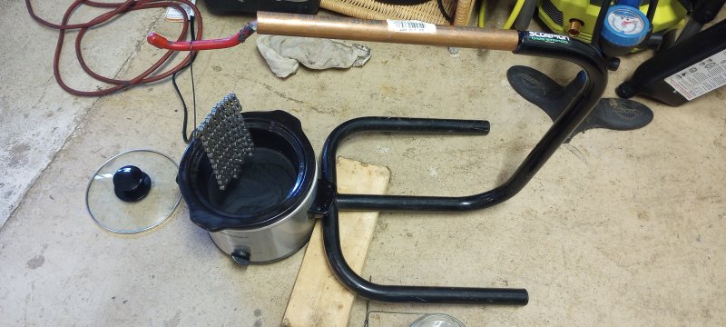

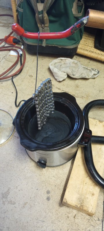

1 hour 15 to melt the Wax 15 minutes to wax three chains.

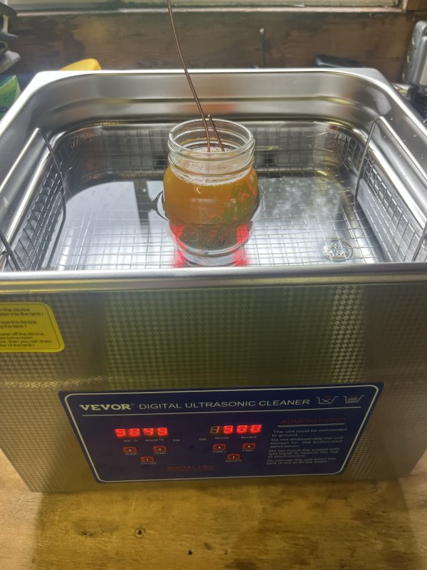

Following some greasy fingers this weekend from a dropped chain, I've now taken a trip down this rabbit hole, this entire thread, YouTube, podcasts, etc. I am considering this at least for my road bike. Regardless I've been wanting an ultrasonic cleaner so its really just the balance. Everything is cued up to purchase.

So I've beein using boiling water to clean used chains before re-applying wax. Do people do multiple rounds of this? I find that the water is usually quite dirty and a single boiling water flush definitely does not get the chain fully clean, which means that the wax gets pretty dirty after only a couple of re-applications.
I just use the park tool chain cleaner with some MucOff bike wash and the chain & cassette come out nice and clean. I've been using Silca drip wax for a little over 2 months, riding 2 or 3 times per week, so not hot waxing. This is only the 2nd time I've had to wash the chain, so aside from wipe downs and re-applications, everything stays pretty clean. Prior to using the drip wax I was using MucOff dry lube and washing my chain weekly to get the grime off of it. Not sure I'd even need to boil it, perhaps to get deeper into the rollers, but honestly the chain stays so clean I highly doubt there's that much more grime to clean out.
Weird. My used chains come out sparking clean after a single prolonged dip in boiling water and wipe with cloth. The one thing that might explain this is that i never top-up wax via drip application. I ride fewer miles between rewaxing instead. I take the view that drip application is never as good as dipping entire chain in wax.
