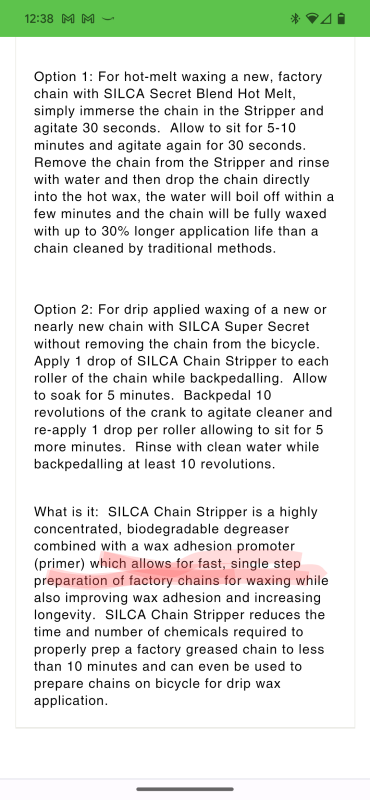

This should save a bunch of time.SILCA just came out with this stuff. Supposed to remove factory grease and be ready for wax in 10 minutes. If it works as advertised, that’s pretty good. Someone should drop the $ and let me know how it works.
Chain Stripper
Remove bike grease and toxic chemicals with the SILCA chain stripper, a one-step, biodegradable cleaning and prep solution for chain waxing.silca.cc

Check the Questions on the page, they say yes but you’ll need to use more.Looks like the new silca stuff is meant for new chains. I'm wondering if using this as a final step in prepping a used chain would work out?

They say this stuff works in 10 minutes, is biodegradable, and helps the wax stick to the chain better. Seems too good to be true, so maybe someone should buy it and try it. I have a 2 chain rotation and they are both showing zero wear, so I dont think I'll be cleaning a new chain any time soon.
