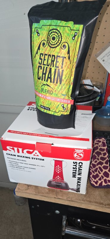

It does. I've been told 40 minutes start to finish
Pump the temp up to 125° to start when you plug it in and let it warm that way, it gets to temp about twice as fast....if you keep it at 75° it takes about 40 minutes.
hmmm? Do I need the Silca crock pot? I have a $9 thrift store Crock Pot that I've been using. It does take some time to melt. Not sure about the temp when I dip it. When it starts to skin over, I pull the chain and let it drip dry.
It really eliminates so much of the headache of waxing, I highly recommend it.

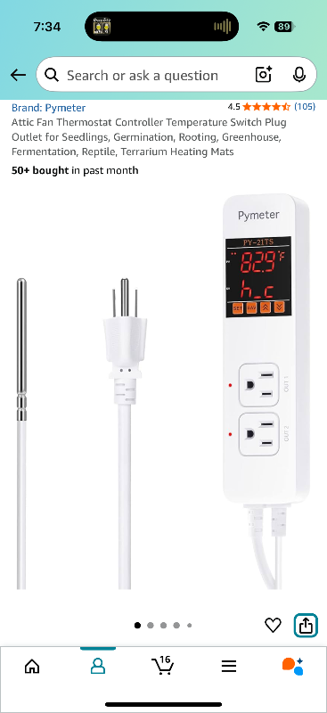

I bought this to use with my crock pot. One plug is set to regulate max temp, so I turn it on high and wait for it to hit temp. The other plug regulates min temp, so I drop the chain in and swap the plug and wait until it hits 75c. This allows me to set it up and walk away without screwing it up.
It maxes out lower than the suggested temp from Silca, but it is effective for keeping the wax from overheating and then overcooling.
Pymeter Thermostat Plug for Fan https://a.co/d/74lE1JV
I bought in the Silca bandwagon, Silca pot, Secret Chain Blend and StripChip (was on sale but of course they slashed the price even further a week after I got it)...tried my first new chain and it was pretty straight forward. The only doubt I have is the correct amount of wax to use, as the Silca Q&A says to add 1 StripChip to 300b of Secret Chain Blend for each new chain, while the StripChip page says to add 1 StripChip to 500g of wax...probably not much of a difference or is it? How is everybody else rolling?
