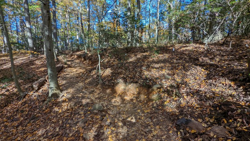

How do you build sustainable lines with 10% grade in sandy Monmouth County soil ?
Add rock and armor the trail.

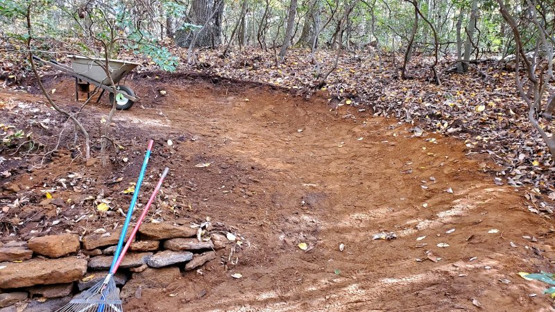

We've been adding rock to the Water Tower flow line for the last month or so. Everyone loves the work we did on this trail last year but it's just too steep for the soil structure and is really hard to maintain.
This rock should help keep the bikes from wearing down the tread and slow down the erosion process. Luckily we have the rock and the crew to make this happen.

This is native rock we added several weeks ago.
We dig the rock in and just leave the top exposed. Dirt washes off the tops when it rains and exposes the natural surface.

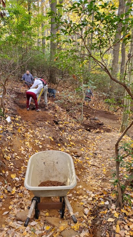

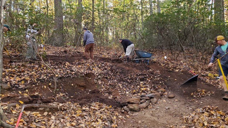

Roughing in the turn.
Roughing in from the top.

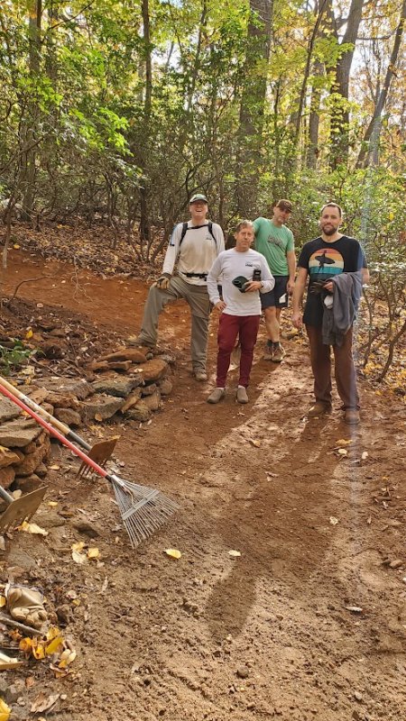

The Crew, Brian, Steve @don , Tim

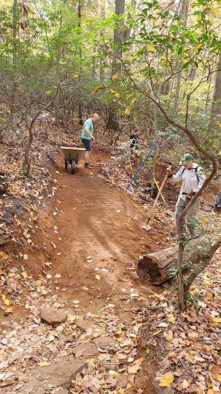

We returned to the upper section of Laurel Ridge yesterday to work on the section of trail leading into the turn we worked on last week.
This area had become a conduit for water on the trail. We added a small reroute yesterday with rolling grade dips to keep water from running down the trail.
The reroute also flows better into the line we worked last week and looks much nicer. The old line was blown out from erosion and trail users seeking a good line.

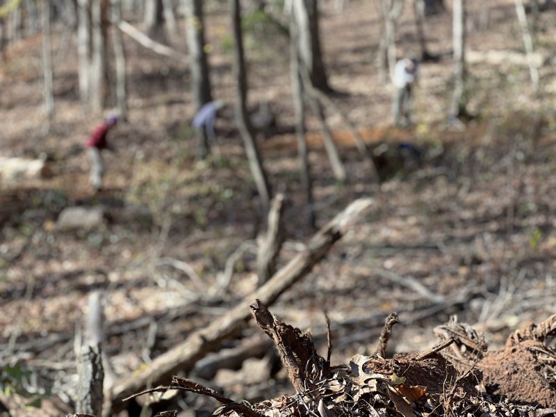

This past Monday we worked our way down Laurel Ridge to the Red Dirt turn. The radius of this turn is tight and sandy due to runoff from higher up on the trail.
This area has bothered me for awhile, while the solution was somewhat simple, it takes time to think these things through. It has to be sustainable, ride better then the old line and not such a drastic change to change the footprint and feel of the trail.
Don helped me scout this out, there were several options and we played them all out. In the end a grade dip before the turn and a wider radius on the turn are what we came up with. We have a few more sessions to get this all in, but what we have so far rides well.
If you are available, come out and help us finish this project. We have a lot of plans but need your help to implement better trails.

Clearing the log jam.

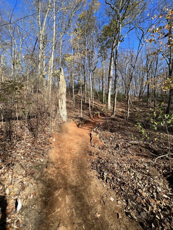

Cooler temps and smaller crew yesterday but still got a lot of little work done. The focus was to keep with "small" changes to the left hand corner at the end of the descent to get that correct radius but also have water shedding capabilities. @pooriggy and @knobbyhead dug out a nice sized stump to get the pitch just right. Beach Boy Brian and I transplanted 20 plus saplings to where the old trail was to rejuvenate it and properly close it off. We all kept a steady pace to keep warm and get shit done.
An artsy pic and a clearer one that shows the full path line of the lower section. We definitely earned the right to get seconds on Thanksgiving Day 😉
This is a significant and needed revision. This section has been degrading over the years, especially in the two corners at the top and bottom.
Old geezers will remember when there was simply a straight fall-line path that eventually disintegrated into a blown-out mess, which necessitated the revision that gave us the switchback at the top and the bench cut connecting to the bottom.
So now we have Version 3.0. 🙂
