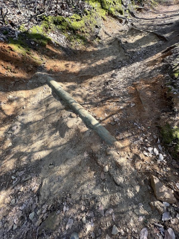

Putting larger and more wood water bars especially at perpendicular angles to the trail direction with hardly an exit throat is not the way to fix erosion issues.
This section of trail had more issues than not from the previous water bars. In my eyes I have only seen wood water bars promote more erosion - they under cut material under them and widen the trail as all users tend to go around them. Plus the Home Depot materials look like shit.
The frustrating part is the erosion issues on this section were for the most part stabilized. Quick fix - I would have taken out the old "water bars" and just left the trail normalize itself. I've done it to a few other areas of this park and I've noticed how more natural the trail becomes and the "erosion issues" fix themselves.
A proper fix would entail a grade reversal at the top to eliminate water getting real speed in the first place. Then creating a little more of a turn at the end to easily get water off the tread and add a little flavor. It's also frustrating that there were ample downslope areas that could have been opened up to shed water and many large rocks that could have been moved to armor the trail.
Sad as there looked to be a lot of very hard work involved - it was just fully mismanaged.
