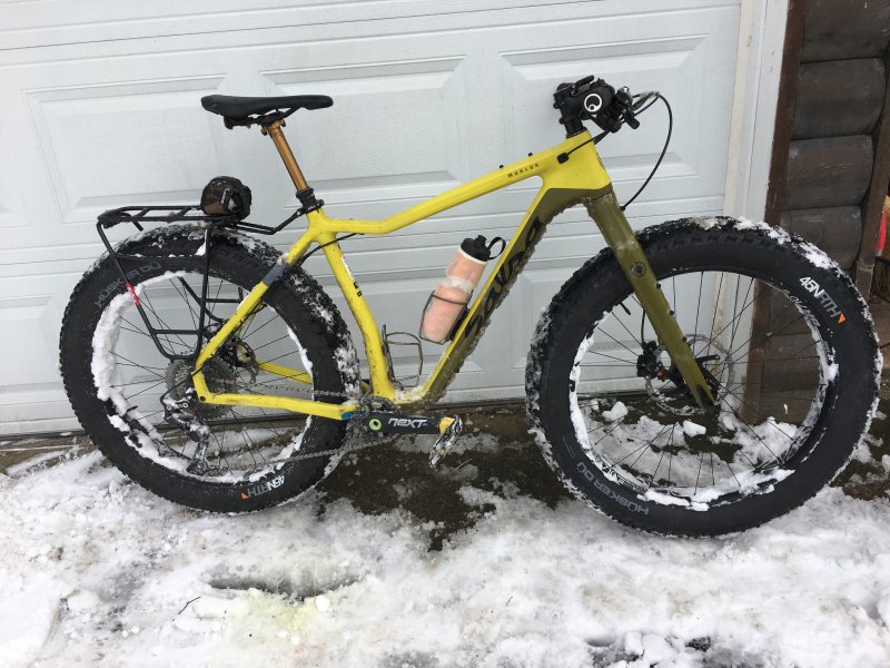

serious contribution now. After clearing the driveway, paths and bushes around the house from the white stuff dumped by snow-mated don I finally tuned the gears on the Mukluk and put back the fat tires. Also shortened the steerer and swapped the rustler bars for some salt flat ones.

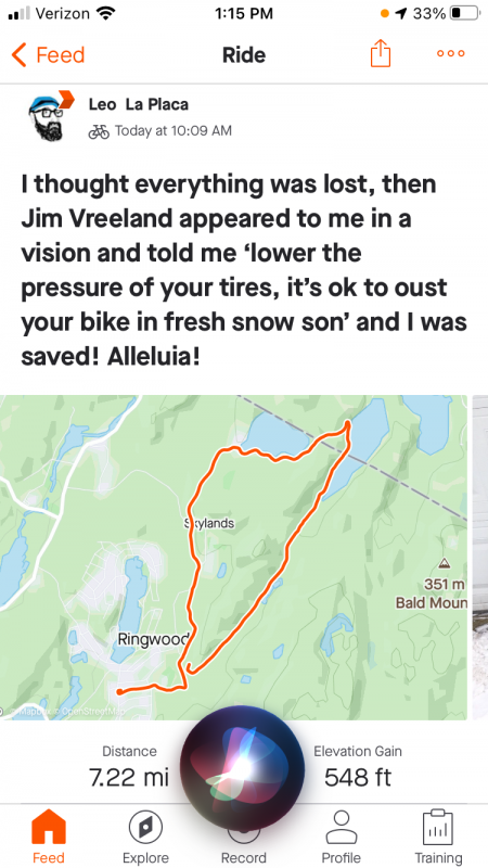

I did something different today, I rode my bike in the snow...wow. Fresh snow...wow. Developed a whole new appreciation for what @jimvreeland thing he does...btw, thanks for the intervention!
picture of the new setup (old setup) after being cleaned from the snow.
