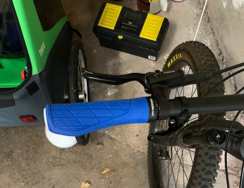

Set the wing higher than you think you need 👍
Yes, they work best with ends slightly higher than level. I have these grips on all my bikes. They've helped with my wrist pain.
Does the wing interfere at all when shit gets rough? Like, dropper down, body low, ass over rear, steep decents at Creek? I get outside hand pain/numbness on longer rides and wondering if these might help with the added support.
Maybe? A bit?
Don't think of them as "support", or you're gonna be real unhappy. Think of them more like "training" yourself to keep your arm/wrist/knuckles inline with each other.
Maybe? A bit?
Yeah what Monkey said. The ends are not that wide on the GA3. Just enough to give some support. I don't see them getting in the way with the bike pointed down.
Probably can rotate your brake levers up a bit thus relaxing the hand and eliminating any discomfort . Especially for gravity type riding . My park bike brake levers are just about parallel to the ground .
Maybe? A bit?
I was hoping the added hand real estate will give some additional support to my palms on the longer 90+ minute, mostly seated rides which may help with the pain i get. But didn't want to compromise grip on the bars when going downhill. I might have to give a pair a try.
i have been riding this style of grip for a while and havnt noticed any issues when going downhill from the wings . . .
As I learned after my incident with the car hitting me, much of it was relegated to weak core muscles. The more I rode with the GA3, the more I kept reminding myself to keep my core engaged, the less my palms/wrists/fingers hurt.
Of course, that also meant that my core (and me) was tired rather than my hands, but, you know. Journey of self-discovery, and all that.

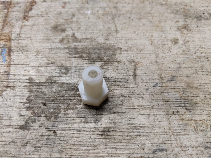

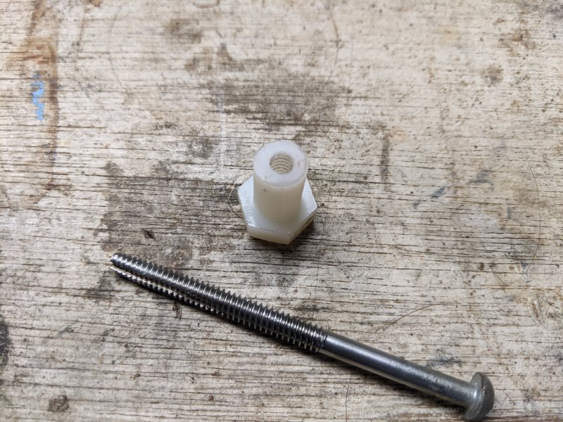

Then, determined not to spend a bunch of money on a tap that I would only use once (okay, twice), I grabbed a suitable 10-24 screw and had at it with a fiber-reinforced cutoff wheel to make 3 channels, then the belt sander to give the nose a nice taper. I zipped a bit off the diameter of the screw while I was at it. The flathead slot was fiddly, but more than sufficient to tap nylon.
The same nylon screw, because, again, lazy.

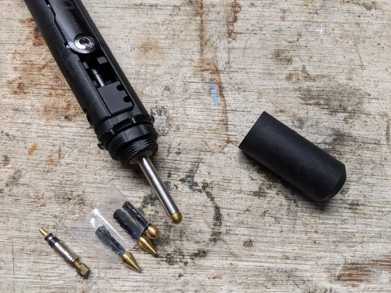

Finally, I grabbed a pair of curved, smooth jaw pliers to turn a tube from Dynaplug into the hole. Remember, I took a bit off the OD of the screw "tap" so it would be a tight fit.
Nice tight fit, no fixative needed, but easy enough to remove both if desired.
All the little dealies fit nicely into the small tube that comes with the tool. The new ribbed o-ring fits into Rockshox stuff, too--it's not dead silent like the fork bung, but it's quiet enough (and that plug is ugly AF). I'm going to take a page from Grandpa and his Camillus electrician's knife, and sharpen the flathead screwdriver bit on the side to make a knife that can cut the plug flush.

So, first things first, rode Huber today for an hour, and pretended the park wasn't a disaster (well, really, it's not, but I try not to consider that 99% of the dirt that's churned/rutted in the turns is horse crap) in order to get the creative juices flowing. Then I grabbed my thinking cap, a handful of 3/8-24 nylon screws, and my drill:
Progress shot, because I'm lazy and skipped photos

Not sure why you had to do that. My OneUp carrier has an alloy adapter for the little fork the is already threaded and servers the same purpose of nylon screw. Wouldn’t have been easier to thread the dynaplug in tube there?
Also not sure about the ribbed o-ring or Rock Shox reference.
Great editorial effort anyway, captioned photos are nice!
Never you mind, you have the V2, probably doesn’t have the same screwed on adapter.
Never never mind, the adapter comes with the little fork which I guess you did not want to purchase.
Never never mind, the adapter Gomes with the little fork which I guess you did not want to purchase.
correct 🙂
