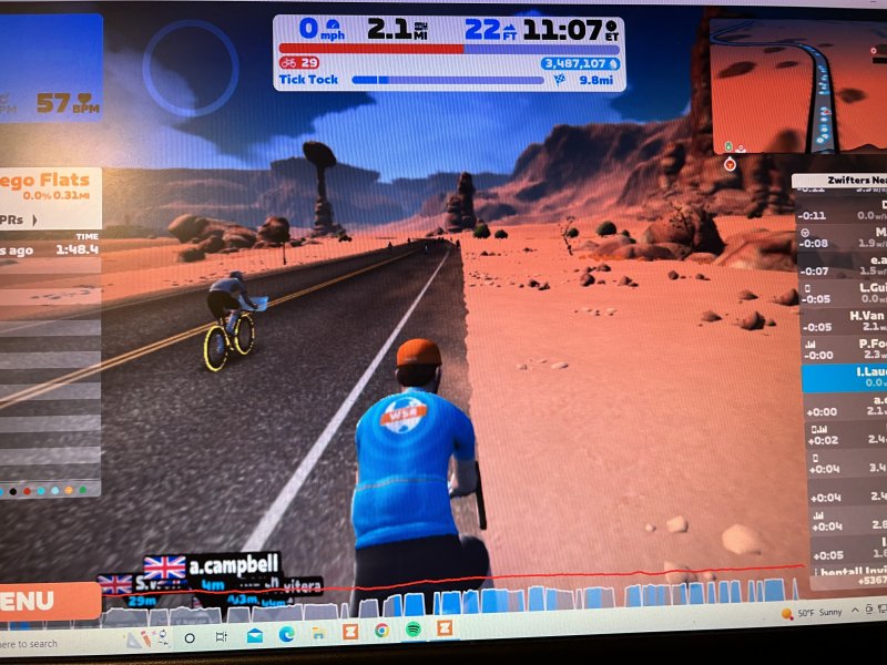

Well now I know the trainer and zwift are working properly I could feel the slight resistance differences when hitting some inclines maintaining my cadence the effort required was more. I probably should have tried a more hilly course to really test it.

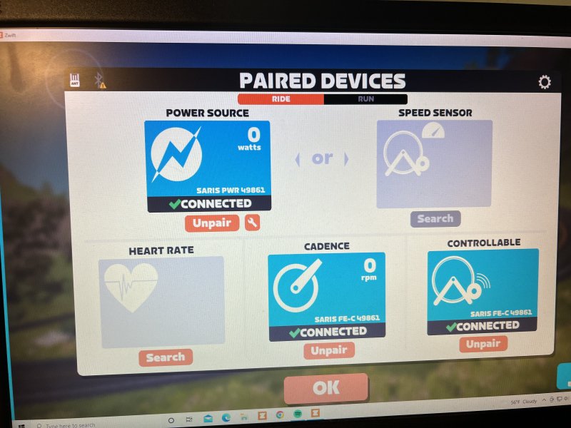

On the downside now I see the ANT connection is very unstable and kept dropping out while I was pedaling continuously even to the point my avatar would stop and take a break while I was spinning the pedals at 90rpm.
Decided this PC is too just old (doesn’t have BT) and need to simplify things so going to get the Apple TV and a decent monitor to treat myself. Especially since my indoor workouts will increase frequency with this new job and I already have to build in time to warm up and calibrate the trainer each session.
Probably go back to the fluid2 for now until I get the appleTV ordered and set up.
My connection is dropping out today as well. Might be a zwift thing. Bluetooth and Ant+
good to know, LMK if your next session is better or not maybe I will try it again or get a $6 BT USB adapter for the PC for now.
