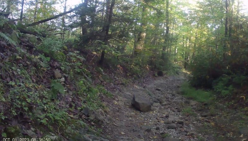

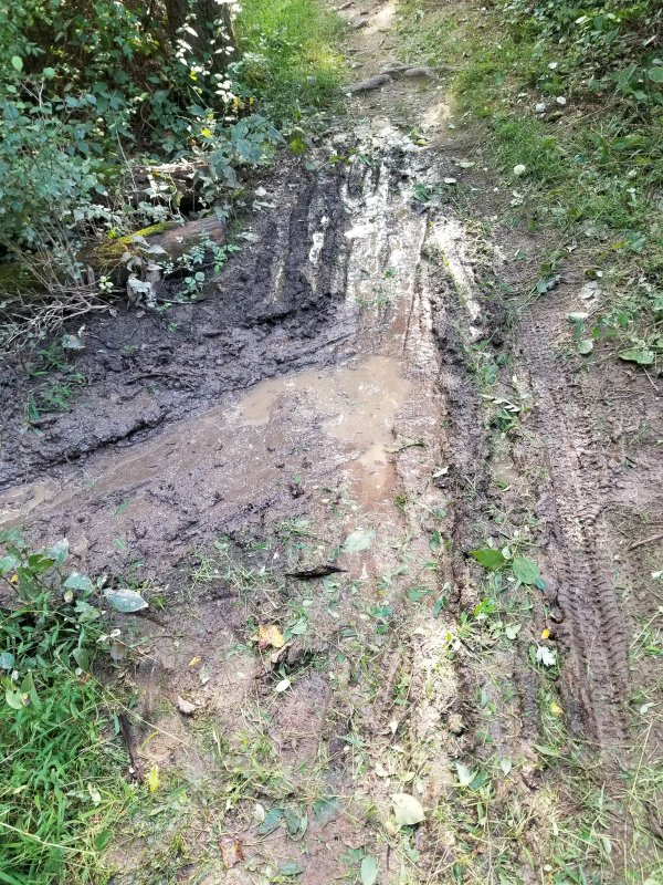

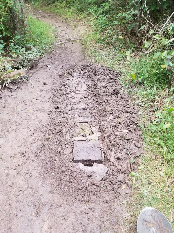

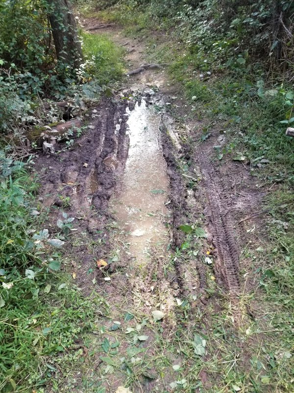

I couldn't help myself. Stick nick did its job - there was no standing water in the rut but it was mushy.
Dug out the low drainage side a little and threw the dirt onto the rut
Found some perfectly square/rectangle rocks from an old stone wall 30 ft away and dug a trench down the middle of the dirt pile for them
Filled rut with rock jigsaw pieces
Pulled dirt back over the top and packed it all in. The low spot is now the high ground. Not perfect but should weather in nice.

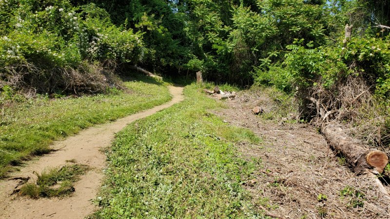

This is how invasive vines get 6' tall. They cling to deadfall along the side of the trail.
It's best to clear deadfall back at least 10' from the trail. This allows an industrial mower to keep the edges of the trail from getting overgrown, without running into dead logs.

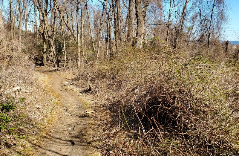

This is good winter work when vegetation is not leafed out. We'll cut back hard for 15" and mow the edge of the trail a few times during the summer. It's so much easier to mow verse using a hedge trimmer.
When this leafs out its a bear to deal with. There was deadfall underneath this mess.

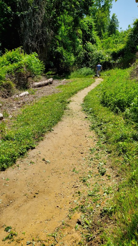

Same trail after a hard cut.
The following June after mowing with Billy Goat.

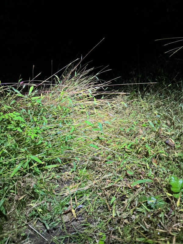

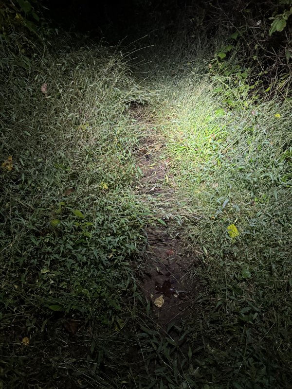

Looks like the highly invasive japanese stiltgrass to me.
The Japanese stiltgrass:
Sorry about the dark pictures, vampire lyf

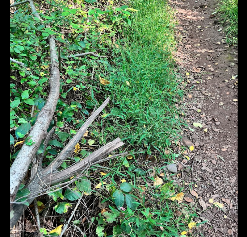

The issue with the Stiltgrass, aside from spreading everywhere there is open space along a trail, is that it grows tall and eventually lays over on the trail. So even if you wait until it dies / goes dormant, you now have a layer of grass on the trail. In general that isnt a great situation and it will hold moisture on the trail tread. The other annoying thing is the way it lays, you have to get under it to cut it, so you can use a weed wacker, but you can easily "miss" near the roots and you trimmed something, but you didnt clear it. It also rips out pretty easy, however that is very time consuming.
This is at Water Company, there is a trail under there.
This picture shows a bit better how it almost makes a canopy over the tread.
I use a hedge trimmer, put the blade under the "canopy" and cut forward or backwards sweeping away from the tread. I an not a huge fan of the sweeping back and forth over the tread and leaving most of the clippings in the tread. I often do a second sweep in the same area to clear the higher stuff. This is a perfect application for the hedge trimmer blade on the end of the weed wacker. But i typically do a full service trim / high and low at the same time and the hedge trimmer works best for that and I can transport it in my backpack...All that being said, it murders my back bending over with the hedge trimmer.
This is exactly what I do. I take the hedge trimmer for this stuff (and other stuff) cut low and sweep away from the trail. Most times I don’t even need to go back with a rake.
