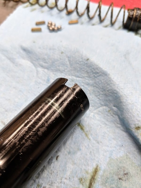

The E13 TRS+ mechanical dropper on my hardtail has developed the typical rotational play so i figured it was time to do a service and replace the brass keys that control this. After digging into it, i found the main seat mast post where the seat head mounts to is cracked underneath. ITs probably been that way for a while and could go for a bit longer still but now that i know its there i just cant bring myself to ride it. Also, because of the crack, the metal is flaring out and scraped up the bushings and seals during disassembly. I put a msg out to E13 about it, lets see what they say.

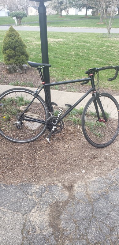

Is this something to bring to attention of Seven Cycles?
Given it's age I'm not terribly surprised. My Rusty bike has a bunch of similar patches. It's just a surface rust forming under the paint, not a big deal. They can totally repair it though.
